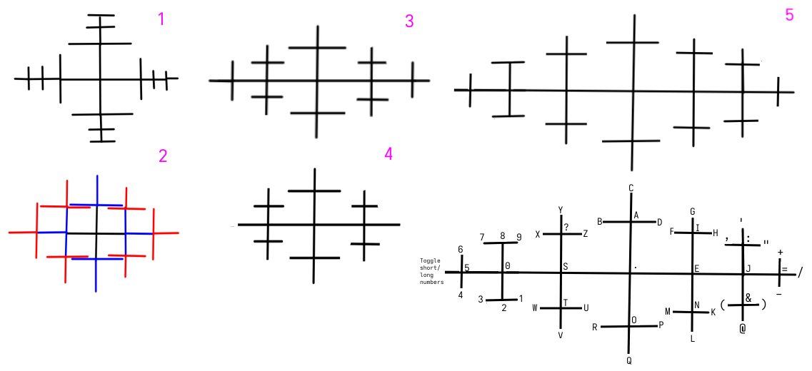

This isn't what I thought I was going to be writing a log about, lol. I did a lot of design today on a fast typing layout for the GBA which I think is really cool- you can access every character in the english alphabet and all the numbers and a bunch of punctuation in less than 5 key presses each, and I made it so more frequently picked characters are closer to the center. Here, I'll just post a picture.

I... I get to learn what a CDN is so I can paste an image here :'D
Edit: It wasn't that hard- just needed to sign in to digital ocean and make a bucket.
Here's the stuff
The idea is that this will open up when text input is needed, with a cursor starting at the center. I tried to make the tree as alphabetical as I could but sacrificed a bit of symmetry in the name of (hopeful) ergonomics. Again, I tried to make more common letters closer to the center. It might be terrible. I got the idea from Dreamshell's text input system which did something similar, but more compact and using the Dreamcast's two joysticks and a trigger to select a character. It felt and looked really cool but was pretty hard to get used to (I said it felt cool, not necessarily good). Since I'm going to ease people into the Morse code one or two characters at a time my idea is I can also ease people into this system just as slowly.
I don't like most text input systems for the GBA and am hoping this will help make the process less frustrating long-term, since my concept for this game will require lots of picking out letters. I also just think it looks cool. I was initially going for a slightly more fractal design, as you can see in my second iteration, which isn't completely off the table, but I want to prioritize function over fashion since I want the game to be fun first and foremost, and the final design with the character mappings just fit so well.
